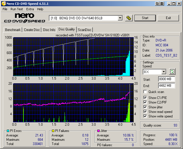

Postby Ian on Thu Jun 22, 2006 11:23 am
Verbatim 16x DVD+R (MCC 004)
Burned with Samsung SH-S182D FW SB01
Written @ 18x
Tested in BenQ DW1640 FW BSLB
Read @ 8x
Samsung SH-S182D Write Quality DVD+R.png (23.62 KiB) Viewed 10743 times

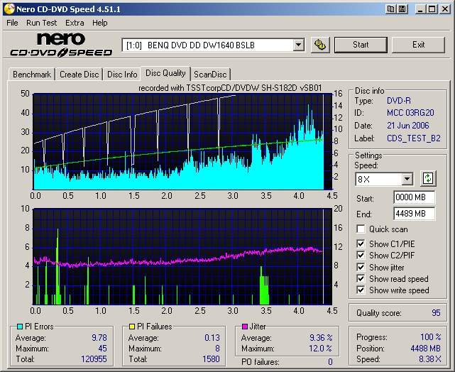

Postby Ian on Thu Jun 22, 2006 11:24 am
Verbatim 16x DVD-R (MCC 03RG20)
Written @ 18x
Read @ 8x
Samsung SH-S182D Write Quality DVD-R.png (25.05 KiB) Viewed 10725 times

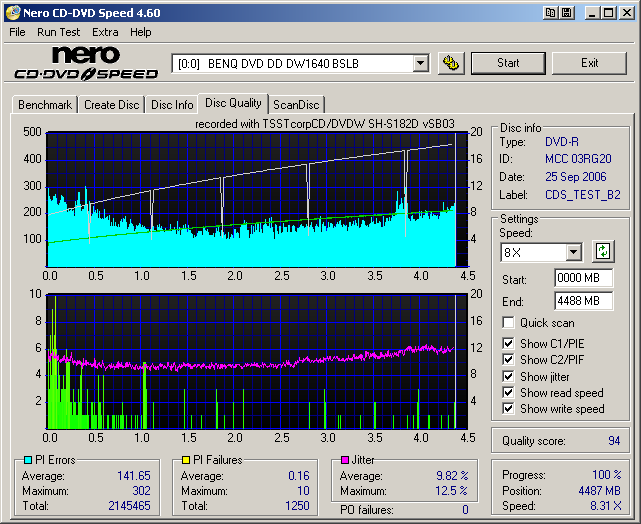

Postby Ian on Tue Sep 26, 2006 12:25 am
Burned with Samsung SH-S182D FW SB03
Written @ 18x
Read @ 8x
Notes: Came in a slim jewel case dated 2004. Made in Taiwan.

Postby Ian on Tue Sep 26, 2006 12:27 am
Written @ 18x
Read @ 8x
Notes: This came in a spindle dated 2006 with the Winkfish promotion. Made in Taiwan.
Winkfish? You must mean Winkflash :P

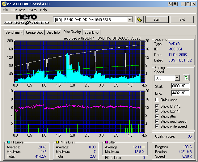

Postby Ian on Thu Oct 19, 2006 9:40 pm
Burned with Sony DRU-830A (SH-S182D clone) FW SS20
Written @ 18x
Read @ 8x
Sony DRU-830A Read Verbatim DVD+R.png (18.71 KiB) Viewed 10330 times

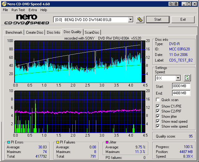

Postby Ian on Thu Oct 19, 2006 9:42 pm
Written @ 18x
Read @ 8x
Sony DRU-830A Read Verbatim DVD-R 2.png (16.77 KiB) Viewed 10328 times
Sony DRU-830A Write Quality Verbatim DVD-R 2.png (21.65 KiB) Viewed 10334 times
