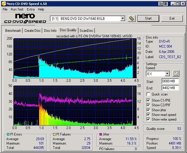

Postby Ian on Fri Apr 07, 2006 9:01 pm
Verbatim 16x DVD+R (MCC 004)
Burned with Lite-On SHM-165H6S FW HS0D
Written @ 16x
HyperTuning Off
Tested in BenQ DW1640 FW BSLB
Read @ 8x
Lite-On SHM-165H6S Write Quality Verbatim 16x DVD+R.jpeg (85.11 KiB) Viewed 8443 times

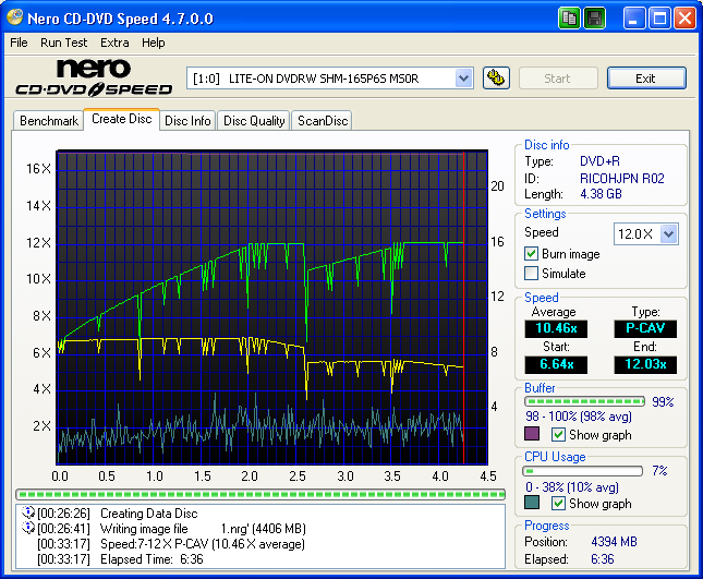

Postby MediumRare on Sun Dec 24, 2006 11:17 am
Platimum 8x DVD+R Printable, 25 pk cakebox
MID: RICOHJPN R02 (003)
Drive: LITE-ON SHM-165P6S
Firmware: MS0R
Disc Type: Video
Burned with: CD-Speed 4.7.0.0
Burn Speed 12x
Time: 6:36 (Leadin: 47 sec)
HT On, OS On, OHT on, Smartburn On

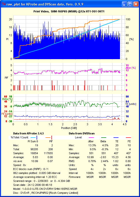

My Philips reflashed to BenQ 1650 didn't like this much, but had no problem reading the disc (impeccable transfer rate not shown). The advanced quality test says this is class 4.
Burn with CD Speed 4.7.0.0
KProbe and DVDScan results
Scan with Philips@BenQ 1650
