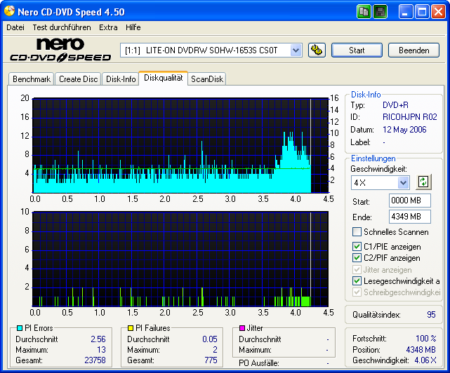

Postby Gabe on Sat Jun 03, 2006 6:20 pm
Burner: Benq DW 1655 BCGB
Media-brand: Traxdata DVD+R 8x
Media-code: RICOHJPN R02
Write-speed: 8x
Traxdata DVD+R 8x Benq 1655 BCGB B.PNG (56.12 KiB) Viewed 22866 times
Traxdata DVD+R 8x Benq 1655 BCGB L.png (53.75 KiB) Viewed 22860 times

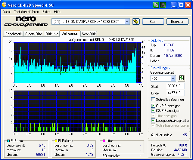

Postby Gabe on Sat Jun 03, 2006 6:51 pm
Media-brand: Rivision DVD-R 16x Printable
Media-code: TTH02
Write-speed: 16x
Rivision DVD-R 16x Benq 1655 BCGB B.png (58.46 KiB) Viewed 22822 times
Rivision DVD-R 16x Benq 1655 BCGB L.png (55.18 KiB) Viewed 22810 times

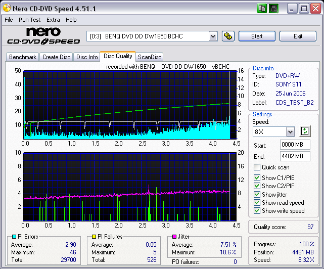

Postby [buck] on Sun Jun 25, 2006 8:35 pm
Sony DVD+RW 4X (made in Japan) - 5pk w/ jewel cases
SONYS11 (virgin disc)
Mirror Band: K3-0001 5TH110CF1
Inner Hub Serial: 44AA5908E
Burned with:
BenQ DW1650 OEM (made in China)
Firmware: BCHC
SolidBurn n/a
WOPC on
Burned at 4x
Smooth TRT! I love this stuff! :D

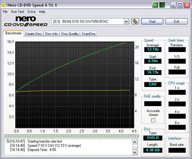

Postby [buck] on Thu Jun 29, 2006 5:03 pm
Acro Circle DVD-R 8X (made in Taiwan) - 50pk spindle from NCIX.com
TYG02 ("borrowed" code)
Mirror Band: R8X DD19 8021
Inner Hub Serial: 0L12MH0405271205B
Burned with:
Firmware: BCHC
SolidBurn on
WOPC on
Burned at 8x
The PIF clump is likely from physical damage.
transfer rate test on DW1640
transfer rate test on DW1650
scan on DW1650
