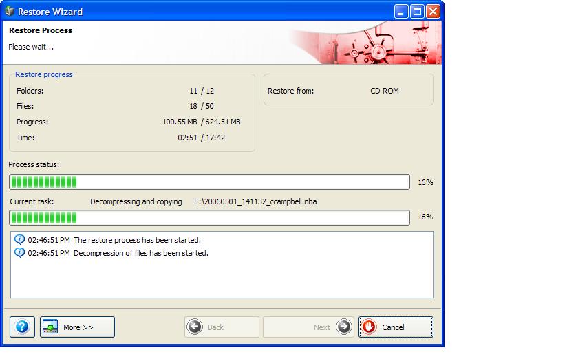

To confirm this, I inserted the disc I did a backup too using Nero BackItUps File backup process, and drag-n-drop the NBA file to my Desktop.
I then launch Nero BackItUp and selected the Restore option, and selected the NBA file from my desktop to restore from, and selected a Temp 4 folder to restore too.
And the restore process completed without any errors.
This screenshot shows my restoring from the NBA file that I had copied from the backup DVD to the Desktop before doing the restore
Restore from NBA file.JPG (50.02 KiB) Viewed 5120 times
