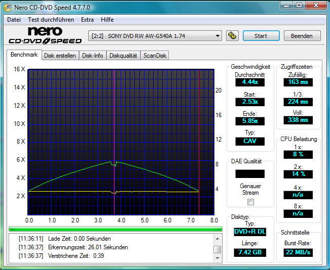

Edit: I now also made a speedtest, because in a different forum they someone said I should do this, but on a different drive, because it doesn't work w/ this drive and my Nero version.
The result looks like the ones I founr w/ google four duoble layer disks, except the small kink in the middle.
But maybe this is because it is a slimline notebook drive, which has only a max. read speed of 6x for DVD+R DL. I haven't found any results fpor drives of this kind.
Also I don' think that the kink comes from a scratch, because I don't have the big scratches so far on the outside.

The TRT test on the notebook looks good, though. The "kink" is the layer break.
Another tip: save you images as PNG files- they're smaller and better suited for these types of diagrams than jpeg's are. CD-Speed normally has a floppy symbol in the title bar that accesses the save dialog. This is missing on your screen shot :o (Vista problem?).

I can access the dialog over the menu, but I found it better to do a screenshot.
Abot the kink: I haven't seen this in other scrennshots of DL media or it was at least much smaller like in this screenshot: http://www.fcenter.ru/img/article/CD_DV ... /97842.png
But maybe this is just because lthe laptop drive slower in every aspect. Even the access time is very high.
