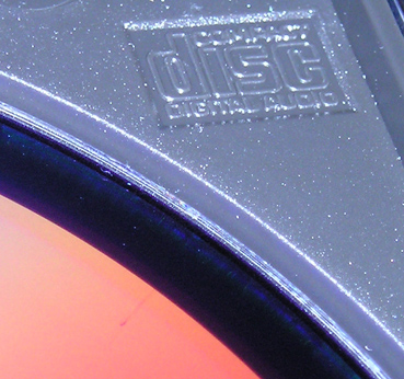

I'm posting a picture (sorry for the intense crop, I wanted to show it close up but fit the attachment limit) and some scans of one of the 'bad' TYG01s... this one luckily started towards the end of the disc so it wasn't a big deal. The disc was not full (only about 3.5gb used)
The picture was HARD to get. I tried all sorts of things and got lucky on this one. Most of the pictures showed nothing, even when I was way up close, macro zoom on, etc. I could barely even see it unless I was under flourescent lights. It's a weird problem with the dye... It's the discolored line pointing almost exactly towards the 'Compact Disc' logo of the case I put it in for pictures.
Hopefully this works since I've never posted pictures before! (The photo is entirely unretouched except for the crop/resize... I didn't touch the gamma, etc.)
Close up of one of the defective Value Line TYG01s.

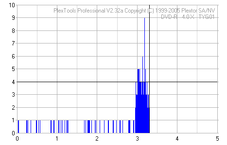

Plextools scans
Postby Justin42 on Sun Feb 26, 2006 10:58 pm
Here are the scans of that disc. PIE is surprisingly good over the flaw, PIF is worse than I thought it'd be given how good PIE was.
It was burned in a Plextor 716UF at 4X (rated speed).
PIE
TYG01 PIE 4X.png (3.79 KiB) Viewed 1374 times
PIF
TYG01 PIF 4X.png (3.42 KiB) Viewed 1371 times
