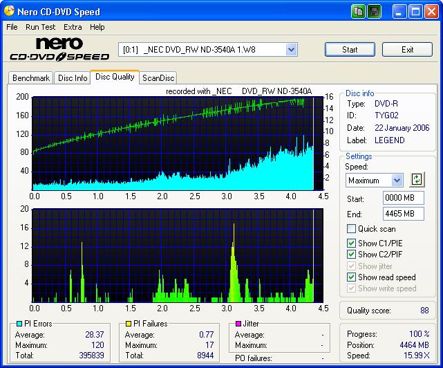

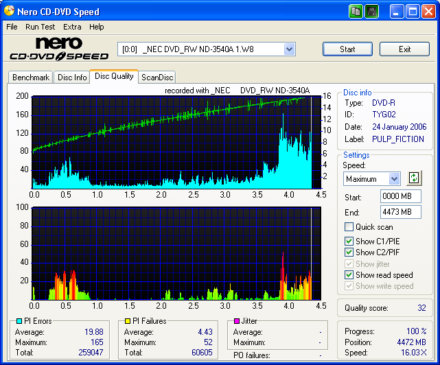

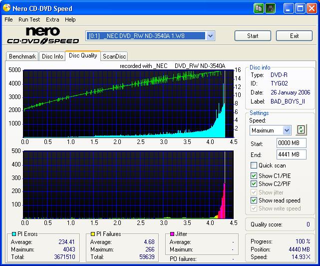

Postby excetara2 on Thu Jan 26, 2006 3:29 pm
Here is three tests with three different burned dvd's. Let me know. This seems like really bad burns to me. THey all seem to work fine.
This is a 2X burn!!!!
This is a 4X burn!!!
This is a 4X burn!!!!

Postby dolphinius_rex on Thu Jan 26, 2006 4:11 pm
NEC drives don't make very good testing devices. The scan is done at full speed though, and the drive seems to have no problem reading the disc at full speed. So completely ignoring the results, and looking just at the transfer rate, I'd say it looks ok. Still, being value line, the life span is not guarenteed.

Postby RJW on Fri Jan 27, 2006 6:07 am
Is the transfer rate curve still fine of that third disc because I think that one possibly could be problematic on some players.
Ohh and this once again proofs do not burn TYG03 at really slow speeds the dye is optimised for higher speeds (6x and 8x). 2x is asking for problems.
Postby dolphinius_rex on Fri Jan 27, 2006 11:20 am
RJW wrote:Is the transfer rate curve still fine of that third disc because I think that one possibly could be problematic on some players.
Remember that the drive was running at 16x... most error scans are done at 4x or 8x, and most transfer rate tests are done at 8x or 12x. Also, NEC drives are not known for being super tolerant readers, especially at high speed! So I still think that chances are decent the media will work alright... but yeah, it's really hard to be 100% sure with NEC or Pioneer based scans.
