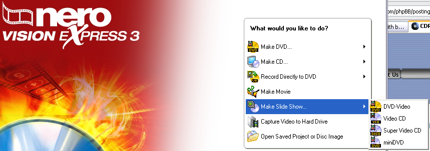

when you start up NeroVision, it asks you What would you like to do, you click on Make Slide Show, what option did you choose? DVD or VideoCD ? if you're gonna record it to a DVD+RW you should choose DVD-Video.

I dont have the same options that you do, I only have option to burn video cd - im starting to think I dont have a full version after all. I think im going to download new software and start again without Nero!!!

if the only option you have is VideoCD, then that's what it's making, a VideoCD is a CD, not a DVD.
apparently your version of NeroVision doesn't support DVD burners.
