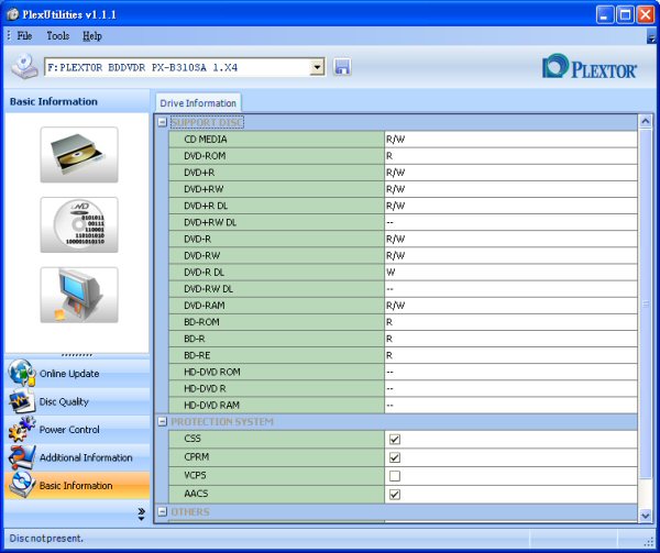

While Plextor's 20x (PX-806SA & PX-Q840U) and 22x (PX-850SA & PX-850A) have not started to ship, their new PlexUTILITIES software is available for download. The link below includes information on its capabilities as well as some screenshots.
Plexutilities Basic Info.jpg (64.24 KiB) Viewed 29145 times
http://www.plextor.com/english/products ... ities.html
http://www.plextor.com/english/support/ ... p1.1.3.zip
Here's some info On PlexUTILITIES:
PlexUTILITIES gives you extra support for your Plextor hardware allowing you to view basic and advance drive information, control specific drive functions to customize drive operations, and includes a powerful utility tool which allows for a safe, secure and easy way to destroy data on CD/DVD media.
Basic information
Drive Information
* Disc type supported by the drive
Ex : CD, DVD-ROM, DVD+R SL/DL, DVD-R SL/DL, DVD+RW …
* Protection system supported by the drive
Ex : CSS, AACS, CPRM …
Disc Information
* Disc type, Disc MID, Media Manufacturer
* Capacity related information
* Write/Read speed performance information
System Storage Controller Information
* Device tree and controller information (IA Storage Features included)
Additional Information
IOP Measurement
* Measure the decay percentage of laser diode of the drive
* CD, DVD, BD are all supported
Engineering Specifications
* Data buffer size and burst rate
* Sustained data transfer rate
* Spin speed
* Start/Stop time
* Spin up/down time
* Random access time
* 1/3 stroke access time
* Full stroke access time
Power Control
Built-in Self Test
* Trigger the drive to perform built-in self test
* Easy, quick and reliable
Audio Settings/ Power Condition
* Set attention level for audio output
* Change standby/idle timing to save more power
PlexERASE
* All data in the disc will be destroyed for safely and securely
Disc Quality
BLER Measurement
* Measure the block error rate for burned disc
* CD : C1/C2
* DVD : PI/PIE
* BD : LDC/BIS
JITTER Measurement
* Measure the jitter level for burned disc
TE/FE Measurement
* Measure the radial noise (tracking error and focusing error) of the disc
* Usually for new blank disc
Online Update
Firmware Upgrade
* Check the latest firmware revision of the drive
* Upgrade drive firmware without reboot needed
PlexUtilities Upgrade
* Check the latest version of PlexUtilities
