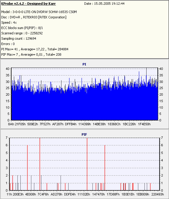

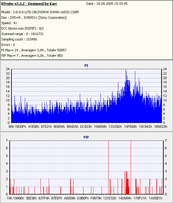

Sony DVD+R 8x 4,7GB @12x NEC 3500 2.TC.PNG (11.89 KiB) Viewed 7072 times
Primedisc DVD+R 8 Olli MP3 1 NEC 3500 2.TC RC3.PNG (11.46 KiB) Viewed 7070 times
Tevion DVD+R 8x @12x Olli Musikvideos 19 NEC 3500 2.19.PNG (12.17 KiB) Viewed 7079 times
