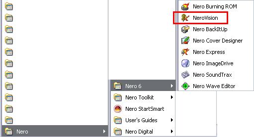

Postby dodecahedron on Sat Apr 15, 2006 1:30 pm
what happens when you click on Nero from Start -> All Programs ?
look at the pics below.
you should have an option (maybe in a submenu) of NeroVision.
that's what Slim is talking about and what you need.
i think you probably have it.
Postby seastars on Sat Apr 15, 2006 1:51 pm
Hmmm. I don't see that. From
Start -> Programs -> Nero
I have these choices (only):
Nero OEM ( Nero CoverDesigner, NeroExpress)
Nero ToolKit (Nero CD-DVD Speed, Nero DriveSpeed, Nero InfoTool)
Users Guides
Nero SmartStart (which takes me to the "choose your catergory: audio, video, etc. screen I describe in my previous post)
Nero Online Upgrade
BUT when I did a search of all my harddrive files for files containing the term "NeroVision," I found three, all 1 KB Internet Shortcuts:
Download NeroVision Express 3.1.0.25 Free Trial
Nero 6 [NeroVision Express 3]
VideoHelp.com - Tools - NeroVision Express
seastars
Posts: 23
Joined: Sun Feb 26, 2006 8:16 pm
Postby dodecahedron on Sat Apr 15, 2006 2:27 pm
seastars wrote:I have these choices (only):
Users Guides
Nero Online Upgrade
sounds to me like you don't have NeroVision.
you can try those shortcuts but they probably lead to webpages (first 2 on Ahead's website), that's all.
you either have to buy another piece of software or try and find a freeware that will do it.
www.doom9.org has lot's of guides and links to download free software. and forums too where you can get help.
i'm sure you'll be able to find there what you need but it will take time to study up.
