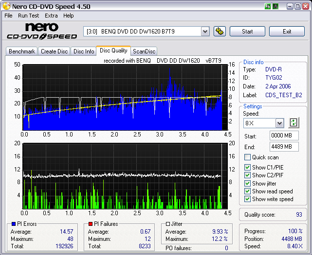

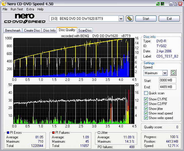

i've had weird things with 4.50 on my BenQ DW1620 - does quality scan of DVDs at 16x !!! even though the specs of the drive are only 8x for DVD+/-R !!! i'll have to see if this still happens in 4.51.1.
here's a couple of scans of Sky brand 8x DVD-R, with a fake TY MID code. same happened once with a DVD+R booktyped to DVD-ROM.
BTW what do you say about this?
the 8x scan seems pretty good, decent i think (these DVDs cost me on sale $4.3 for a spindle of 25). opinions?
this are the first fake MID DVDs i've seen. i wonder how they'll hold out over time.
the 16x scan is weird! (apart from the fact that the drive isn't supposed to be able to read DVD-R at 16x!). note the dips in the jitter curve as well.
Quality Scan with speed set to 8x
Quality Scan with speed set to maximum
Postby TCAS on Thu Apr 13, 2006 10:13 am
In these two burns obviously you can see the disc have quality issue and jitter in both discs are questionable. I would not used these discs for any significant or long maintained recording.
