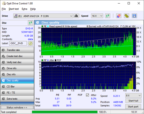

Sony 16x DVD-R (SONY16D1):
Lite-On iHAS124 - Sony DVD-R Quality.png (192.39 KiB) Viewed 23539 times

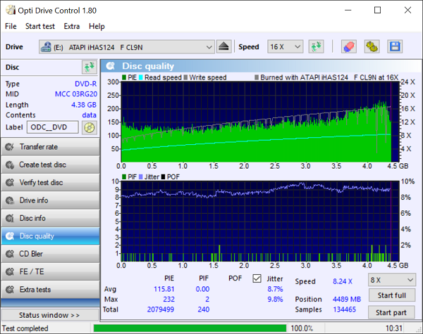

Verbatim 16x DVD-R (MCC 03RG20):
Lite-On iHAS124 - Verbatim DVD-R Quality.png (202.61 KiB) Viewed 23539 times

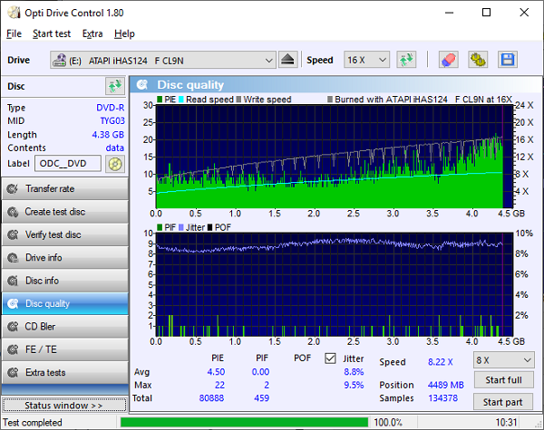

Taiyo Yuden 16x DVD-R (TYG03):
Lite-On iHAS124 - Taiyo Yuden DVD-R Quality.png (191.94 KiB) Viewed 23539 times

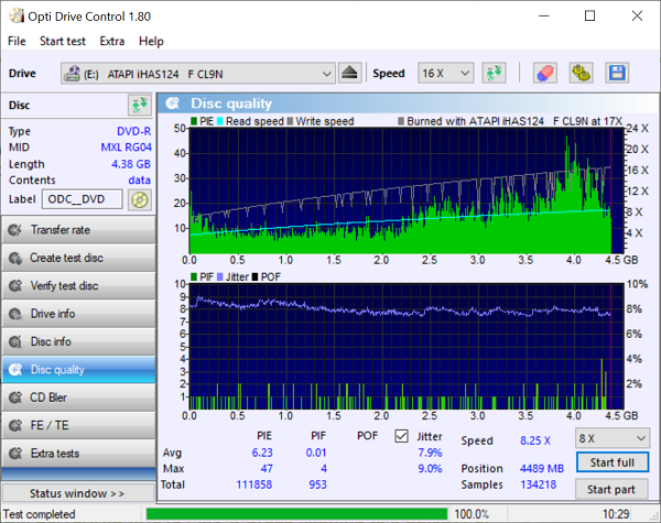

Ritek Pro 16x DVD-R (MXL RG04):
Lite-On iHAS124 - Ritek Silver DVD-R Quality.png (211.74 KiB) Viewed 23539 times

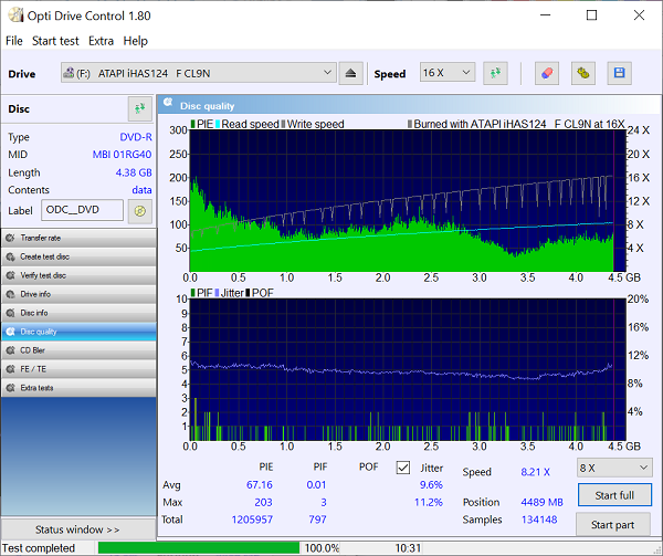

Moser Baer Pro Select 16x DVD-R (MBI 01RG40):
Lite-On iHAS124 - MBI Pro Select DVD-R Quality.PNG (168.47 KiB) Viewed 23539 times

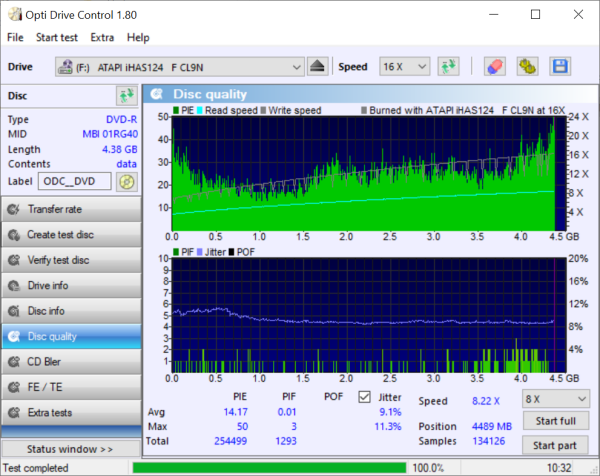

None of the drives were able to write to MBI's Zebra DVD-R media at 20x or 24x. However, all of them wrote to it at its rated speed (16x). The writing quality was also pretty good for the most part. The PI rates were fairly low and, aside from a few spikes near the end of a few discs, the PIF rates stayed within the acceptable range.
Lite-On iHAS124 F:
Lite-On iHAS124 - MBI Zebra DVD-R Quality.PNG (141.47 KiB) Viewed 23461 times
