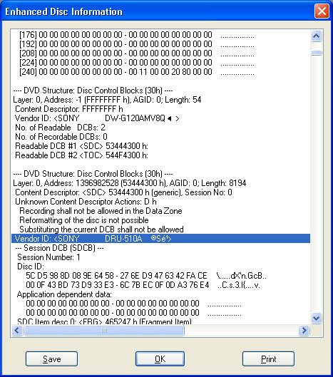

dodecahedron wrote:2. you also get the drive and firmware recorded on the media.
The drive used to write a disc is available on every DVD- at least in a rudimentary way.
You can see it with Nero. Click on the "Info" icon and then "Shift Control Refresh" to display the "Enhanced Disc Information".
This shows a wealth of infomation (including the ADIP with MID-Information). Look for "Disc Control Blocks"- there will be a lot of these entires. The first one shows information about the drive reading this info in the Vendor-ID. In my case, the LiteOn SHM-16P6S is identified as its Sony equivalent:
Code: Select all
<SONY            DW-G120AMV8Q   >
(this text is stored in the firmware, version MV8Q in this case).
The other entries all apply to the drive that wrote the disc, so to definitely identify it, it's easiest just to jump to the end of the displayed list to find this information, in this case:
Code: Select all
<SONY            DRU-510A    ®Sé¹>
(as highlighted in the attached screenshot).
Excerpt from "Enhanced Disc Information". The burning drive is highlighted.

no vendor ID !!
i can't see in either any idication of which drive burned the disc.
maybe it's a software feature?
Postby MediumRare on Mon May 08, 2006 5:29 pm
1. I haven't seen a difference since a finalizing bug in CD-Speed was eliminated. I know that there have been reports on incompatibility with Nero video DVD's. The only confirmed one I've seen is re. short VOB's: see http://forum.digital-digest.com/showthr ... adid=45025 (alexnoe occsionally refered to this in normal acerbic style).
2. Your information shows that one shouldn't make sweeping conclusions from limited data. [-X
Here's the (almost) complete Enhanced Date Information from the disc that the posted sample was from:

All recorded DVD's (-R, +R, +RW, +RDL), I've looked at have had this information, in particular those I didn't burn myself (Sony DRU-510A, Philips, NEC, Samsung), so I assumed that the information is always present. It may be that they were all burned by Nero and that Nero and/or Nero CD-Speed add this information. Or maybe only LiteOn drives report it?
In any case, if you're not seeing this information, it's not universal. Someone else with better background knowledge or greater variety of burners/burning programs will have to nail this down. My information is apparently too one-sided. :o
Postby dodecahedron on Mon May 08, 2006 5:47 pm
that is certainly a lot of Enhanced Disc Information :D
