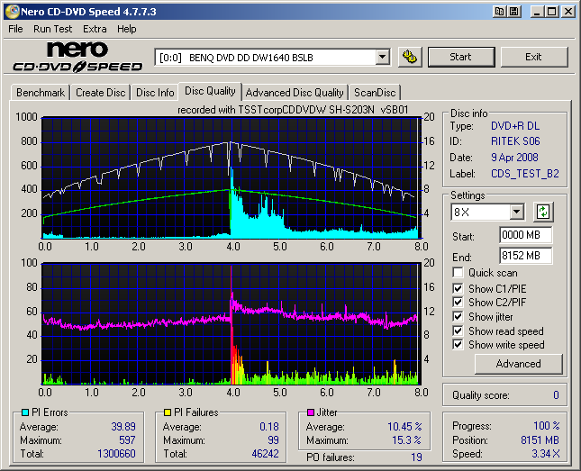

Traxdata 16x DVD+R DL (RITEK S06)
Burned with Samsung SH-S203N FW SB01
Written @ 16x
Tested in BenQ DW1640 FW BSLB @ 8x
Traxdata 16x DVD+R DL Read BenQ-Fail.png (18.67 KiB) Viewed 13194 times
Traxdata 16x DVD+R DL Write Quality BenQ.png (26.11 KiB) Viewed 13192 times

Here are a few more screenshots. Looking at the KProbe results, you can see a large spike at the layer change. Surprisingly, the SH-S203N had no problems reading the disc back.

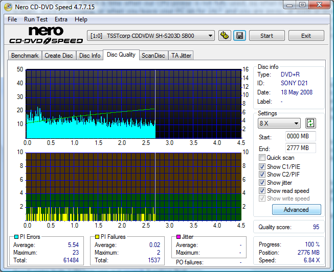

good test i think
Same scan as http://www.cdrlabs.com/forum/viewtopic.php?p=173504#173504

What drive was that burned with?
This thread is for scans of discs burned with the Samsung SH-S203. Not just tested with it.

This DVD was burned and scanned wuth the Samsun SH-S203D
